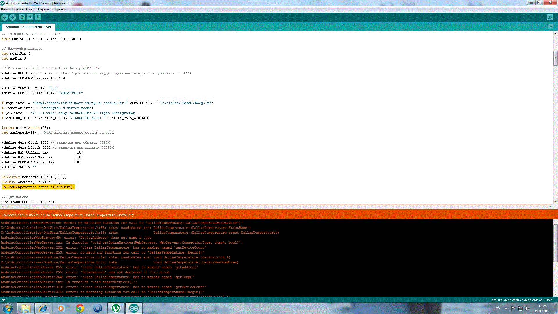

Наконец все приехало, но не как не получается залить скейч, замучился кочать библиотеки
#include "WebServer.h"
#include <OneWire.h>
#include <DallasTemperature.h>
пришлось вьезжать
Куча ошибок
ArduinoControllerWebServer:66: error: no matching function for call to 'DallasTemperature::DallasTemperature(OneWire*)'
C:\Arduino\libraries\OneWire/DallasTemperature.h:63: note: candidates are: DallasTemperature::DallasTemperature(StratBase*)
C:\Arduino\libraries\OneWire/DallasTemperature.h:38: note: DallasTemperature::DallasTemperature(const DallasTemperature&)
ArduinoControllerWebServer:69: error: 'DeviceAddress' does not name a type
ArduinoControllerWebServer.ino: In function 'void get1wireDevices(WebServer&, WebServer::ConnectionType, char*, bool)':
ArduinoControllerWebServer:252: error: 'class DallasTemperature' has no member named 'getDeviceCount'
ArduinoControllerWebServer:253: error: no matching function for call to 'DallasTemperature::begin()'
C:\Arduino\libraries\OneWire/DallasTemperature.h:69: note: candidates are: void DallasTemperature::begin(uint8_t)
C:\Arduino\libraries\OneWire/DallasTemperature.h:78: note: void DallasTemperature::begin(NewOneWire&)
ArduinoControllerWebServer:255: error: 'class DallasTemperature' has no member named 'getAddress'
ArduinoControllerWebServer:255: error: 'Termometers' was not declared in this scope
ArduinoControllerWebServer:264: error: 'class DallasTemperature' has no member named 'getTempC'
ArduinoControllerWebServer.ino: In function 'void searchDevices()':
ArduinoControllerWebServer:310: error: 'class DallasTemperature' has no member named 'getDeviceCount'
ArduinoControllerWebServer:311: error: no matching function for call to 'DallasTemperature::begin()'
ArduinoControllerWebServer:314: error: 'class DallasTemperature' has no member named 'getAddress'
ArduinoControllerWebServer:314: error: 'Termometers' was not declared in this scope
ArduinoControllerWebServer:325: error: 'class DallasTemperature' has no member named 'getResolution'
ArduinoControllerWebServer:327: error: 'class DallasTemperature' has no member named 'getTempC'
ArduinoControllerWebServer.ino: In function 'void setup()':
ArduinoControllerWebServer:361: error: no matching function for call to 'DallasTemperature::begin()'
ArduinoControllerWebServer:362: error: 'class DallasTemperature' has no member named 'requestTemperatures'
все равно лажа может чтото не так делаю мега 2560+5100

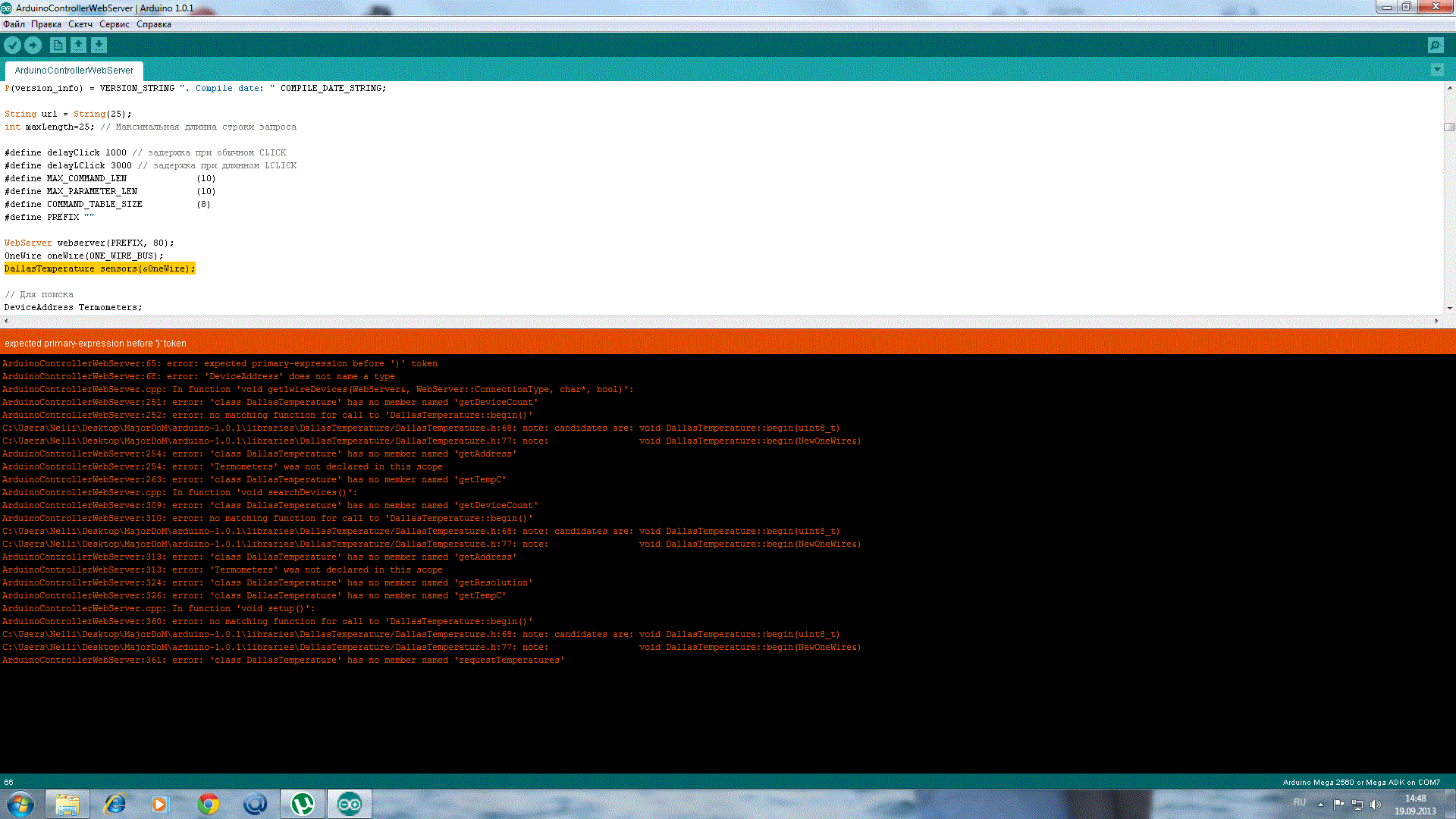

Какая версия Arduino IDE ?
Ещё для езернет надо #include <Ethernet.h> #include <SPI.h>
100% рабочее для Arduino IDE 1.0.х : http://homes-smart.ru/upload/arduino/Da ... rature.zip и http://homes-smart.ru/upload/arduino/OneWire.zip
Denis_1704
Сообщения: 29
Зарегистрирован: Вт авг 06, 2013 11:04 pm
Re: Помогите выбрать Железо
Сообщение Denis_1704 »
Не чего не получается ИД 1.0.5
Не получается ИД 1.0.1
испытывал 017 тоже не выходит наверное я чтото не догоняю
