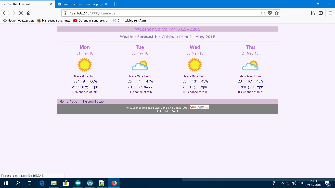

3. Ну и наконец страница создается вообще не понятно как, но так работают все интернет-технологии. Используется библиотеки
#include <ESP8266WiFi.h>
#include <ESP8266WebServer.h>
#include <WiFiClient.h>
#include <ArduinoJson.h>
#include <DNSServer.h>
Ну и сам код страницы
void homepage(){
  append_page_header();
  webpage += F("<hr>");
  webpage += F("<table class='style7'>");
  webpage += F("      <tr>");
  webpage += "          <th>"+DWDay1+"</th>";
  webpage += "          <th>"+DWDay2+"</th>";
  webpage += "          <th>"+DWDay3+"</th>";
  webpage += "          <th>"+DWDay4+"</th>";
  webpage += F("      </tr>");
  webpage += F("        <td>");
  webpage += "            "+DDateDa1+"-"+DMon1+"-"+DDateYr1;
  webpage += F("        </td>");
  webpage += "            "+DDateDa2+"-"+DMon2+"-"+DDateYr2;
  webpage += "            "+DDateDa3+"-"+DMon2+"-"+DDateYr3;
  webpage += "            "+DDateDa4+"-"+DMon3+"-"+DDateYr4;
  webpage += "          <td> <img class='imgdisplay' alt='wx' height='70' src='"+Dicon_url1+"' width='70'/></td>";
  webpage += "          <td> <img class='imgdisplay' alt='wx' height='70' src='"+Dicon_url2+"' width='70'/></td>";
  webpage += "          <td> <img class='imgdisplay' alt='wx' height='70' src='"+Dicon_url3+"' width='70'/></td>";
  webpage += "          <td> <img class='imgdisplay' alt='wx' height='70' src='"+Dicon_url4+"' width='70'/></td>";
  webpage += F("        <td class='style8'>Max - Min - Hum</td>");
  webpage += F("        <td class='style9'>");
  webpage += "            &nbsp"+DHtemp1+"&deg;&nbsp;&nbsp;&nbsp;&nbsp"+DLtemp1+"&deg;&nbsp;&nbsp;&nbsp;&nbsp"+DHumi1+"%</td>";
  webpage += "            &nbsp"+DHtemp2+"&deg;&nbsp;&nbsp;&nbsp;&nbsp"+DLtemp2+"&deg;&nbsp;&nbsp;&nbsp;&nbsp"+DHumi2+"%</td>";
  webpage += "            &nbsp"+DHtemp3+"&deg;&nbsp;&nbsp;&nbsp;&nbsp"+DLtemp3+"&deg;&nbsp;&nbsp;&nbsp;&nbsp"+DHumi3+"%</td>";
  webpage += "            &nbsp"+DHtemp4+"&deg;&nbsp;&nbsp;&nbsp;&nbsp"+DLtemp4+"&deg;&nbsp;&nbsp;&nbsp;&nbsp"+DHumi4+"%</td>";
  webpage += "            "+winddirsymbol(&DW_dir1) + " @ " + DW_mph1;
  webpage += "            "+winddirsymbol(&DW_dir2) + " @ " + DW_mph2;
  webpage += "            "+winddirsymbol(&DW_dir3) + " @ " + DW_mph3;
  webpage += "            "+winddirsymbol(&DW_dir4) + " @ " + DW_mph4;
  webpage += F("        <td class='style8'>");
  webpage += "            "+DPop1+"% chance of "+((DRain1=="0mm"||DRain1=="0in")?"rain":DRain1+" rain");
  webpage += "            "+DPop2+"% chance of "+((DRain2=="0mm"||DRain2=="0in")?"rain":DRain2+" rain");
  webpage += "            "+DPop3+"% chance of "+((DRain3=="0mm"||DRain3=="0in")?"rain":DRain3+" rain");
  webpage += "            "+DPop4+"% chance of "+((DRain4=="0mm"||DRain4=="0in")?"rain":DRain4+" rain");

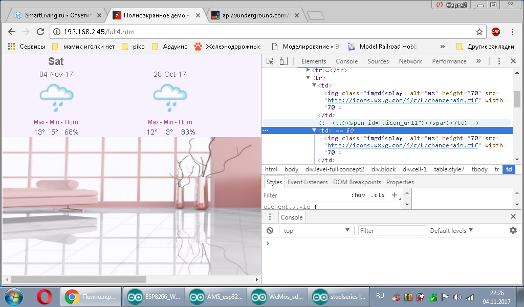

Учитывая,что в АМС на ЕСП8266 остается 15 % памяти, догадываюсь, что она лежит в ОЗУ. Но таким образом не получается создать саму страницу, потому что она вызывается по порту 5000. А в коде уже задействован порт 8080 для HTTP. Получается конфликт интересов.)) Поэтому просто нарисовал нужный контент и через Ажакс вывел необходимые цифры.
Первая колонка реальная, остальные нарисованные. Вот только с картинкой тучек не получается - я могу через XML таблицу отправить ссылку в браузер.
  • <inputs>
    <mRtc>1</mRtc>
    <mEthernet>2</mEthernet>
    <month>11</month>
    <weekday>7</weekday>
    <c1Temp1>0.00</c1Temp1>
    <mega>0</mega>
    <DHtemp1>13</DHtemp1>
    <DLtemp1>5</DLtemp1>
    <DHumi1>68</DHumi1>
    <DWDay1>Sat</DWDay1>
    <DDateDa1>04</DDateDa1>
    <DMon1>Nov</DMon1>
    <DDateYr1>17</DDateYr1>
    <Dicon_url1>http://icons.wxug.com/i/c/k/partlycloud ... Dicon_url1>
    </inputs>
Но как её (ссылку) вызвать на самой странице? Обратиться к ней просто
     <tr>
      <td><img class='imgdisplay' alt='wx' height='70' src='http://icons.wxug.com/i/c/k/chancerain.gif' width='70'/></td>
      <!--<td><span id="dicon_url1"></span></td>--> // так не работает
      <td><img class='imgdisplay' alt='wx' height='70' src='http://icons.wxug.com/i/c/k/rain.gif' width='70'/></td>
      <td><img class='imgdisplay' alt='wx' height='70' src='http://icons.wxug.com/i/c/k/partlycloudy.gif' width='70'/></td>
     </tr>
Но надо чтобы она менялась согласно XML таблице.......

....Проще было написать километровую страницу, чем бороться с роботом...
...Получил JSON строку , распарсил и через Ажакс отправил в браузер. На каждый из четырех дней аж 13 переменных. В том числе и картинка с тучками ( на сервисе . В ответ приходит URL ).

Числа расставить по местам очень просто. Сложнее с картинками. Самое легкое - вставить ссылку на иконку.
      <td>
      </td>
Ссылка реальная. А вот как её менять на странице в зависимости от XML таблицы ? Фокус со скриптом не получается. Как правильно это сделать ?

В продолжение темы. Первоисточник я уже не найду , но все это удалось воткнуть в AMS , залезть на сайт, получить ответ в JSON и вывести кое что на страницу. В оригинале код страниц похоже сидит в памяти 8266 и выводится в браузер на 5000 порту. Полный код вкладки
wungergr.zip
(6.48 КБ) 254 скачивания
Тогда собственно остался один вопрос. В XML таблице выводятся 4 ссылки на иконки " тучек"

Еще раз. Это все отлично работает уже полгода. Дело техники вывести всё на TFT экран. Затык только с картинками.

Это как вариант был. В XML попадает актуальная ссылка
<Dicon_url1>http://icons.wxug.com/i/c/k/clear.gif</Dicon_url1> // Как её вытащить на страницу ??
Скрипта под рукой нет , а в HTML код вставляю так
     <tr>
     </tr>
В первой строчке честно вставляется картинка по ссылке. А надо из таблицы.

Если не получается стандартными средствами AMS вставить ссылку на картину из XML таблицы , то поднял всё таки другой сервер на 8266 и сформировал страницу в коде. Теперь вижу актуальную инфу .
И к стати о погоде )). Этот сайт работает очень адекватно вот уже год. Ключ API не менял. Выдает прогноз на 4 дня. Достаточно верный. Позволяет достукиваться до 500 раз в сутки. Обновление погоды не отслеживал. API бесплатный. 9 видов иконок.На ESP8266 выглядит так
На ESP32 тот же код не достукивается до сайта. Хотя если запустить отдельно от AMS , то всё получается ( правда выводит на OLED экран 1"3 дюйма).
