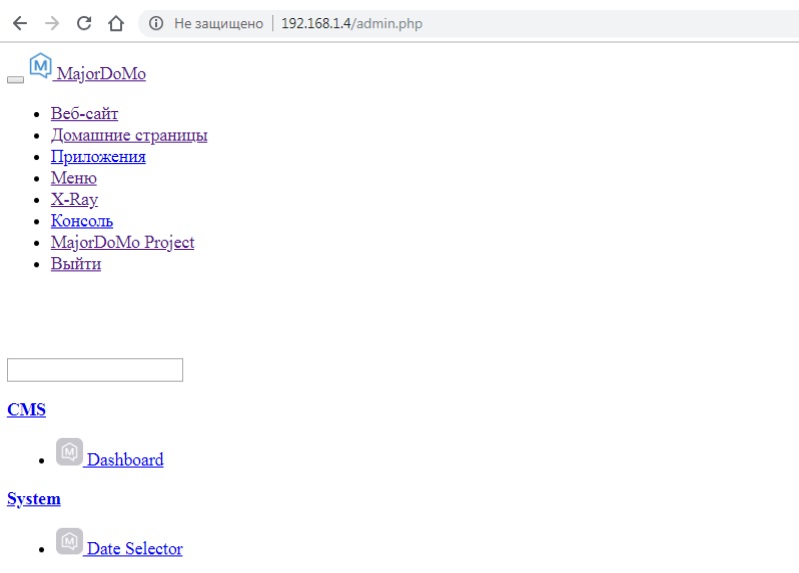

Сообщение ученик » Ср ноя 28, 2018 5:33 am
ПОМОГИТЕ
Не дается мне, что-то вебморда!
как вернуть в прежнее состояние ?
Ни скрипты подправить, ни влезть никуда
То что управляется скриптами то работает
то что управлялось кнопками в меню
не работает
какие то ошибки в логе 2018-11-28_javascript_errors.log
02:13:21 0.51647300  URL: http://192.168.1.4/js/jquery.autocomplete.js - Uncaught ReferenceError: jQuery is not defined; line: 759
02:13:21 0.52983000  URL: http://192.168.1.4/js/jquery.bgiframe.js - Uncaught ReferenceError: jQuery is not defined; line: 10
02:13:21 0.55302100  URL: http://192.168.1.4/js/jquery.betterTooltip.js - Uncaught ReferenceError: $ is not defined; line: 9
02:13:21 0.61142500  URL: http://192.168.1.4/js/jWindow.js - Uncaught ReferenceError: jQuery is not defined; line: 1075
02:13:21 0.63052400  URL: http://192.168.1.4/js/jquery.tiny-pubsub.js - Uncaught ReferenceError: jQuery is not defined; line: 25
02:13:21 0.65166400  URL: http://192.168.1.4/admin.php - Uncaught ReferenceError: $ is not defined; line: 85
02:13:21 0.67142800  URL: http://192.168.1.4/admin.php - Uncaught ReferenceError: jQuery is not defined; line: 1868
02:13:22 0.01351600  URL: http://192.168.1.4/admin.php - Uncaught ReferenceError: $ is not defined; line: 3338
02:13:22 0.01717500  URL: http://192.168.1.4/admin.php - Uncaught ReferenceError: $ is not defined; line: 3312
02:21:30 0.60213000  URL: http://192.168.1.4/js/jquery-ui-1.9.1.custom.min.js - Uncaught ReferenceError: jQuery is not defined; line: 6
02:21:30 0.61951900  URL: http://192.168.1.4/js/jquery.tiny-pubsub.js - Uncaught ReferenceError: jQuery is not defined; line: 25
02:21:30 0.62388500  URL: http://192.168.1.4/ - Uncaught ReferenceError: $ is not defined; line: 90
02:21:30 0.62559300  URL: http://192.168.1.4/ - Uncaught ReferenceError: jQuery is not defined; line: 108
02:21:30 0.65080100  URL: http://192.168.1.4/js/ui.tabs.paging.js - Uncaught ReferenceError: jQuery is not defined; line: 348
02:21:30 0.69383300  URL: http://192.168.1.4/ - Uncaught TypeError: Cannot read property 'appendChild' of null; line: 304
02:21:30 0.72625200  URL: http://192.168.1.4/ - Uncaught ReferenceError: $ is not defined; line: 578
02:21:30 0.73508600  URL: http://192.168.1.4/ - Uncaught ReferenceError: $ is not defined; line: 932
02:21:31 0.07613200  URL: http://192.168.1.4/menu.html - Uncaught ReferenceError: $ is not defined; line: 72
02:21:31 0.07668900  URL: http://192.168.1.4/js/jquery.tiny-pubsub.js - Uncaught ReferenceError: jQuery is not defined; line: 25
02:21:31 0.0964940002:21:31 0.09649400  URL: http://192.168.1.4/menu.html - Uncaught ReferenceError: $ is not defined; line: 2390
  URL: http://192.168.1.4/menu.html - Uncaught ReferenceError: $ is not defined; line: 123
02:21:32 0.05359400  URL: http://192.168.1.4/menu.html - Uncaught ReferenceError: $ is not defined; line: 141
02:21:34 0.06574800  URL: http://192.168.1.4/menu.html - Uncaught ReferenceError: $ is not defined; line: 1905
02:21:37 0.29119900  URL: http://192.168.1.4/menu.html - Uncaught ReferenceError: $ is not defined; line: 300
02:21:43 0.88490100  URL: http://192.168.1.4/menu.html - Uncaught ReferenceError: $ is not defined; line: 300
server i5, OS-Ubuntu Server 16., 1-wire
