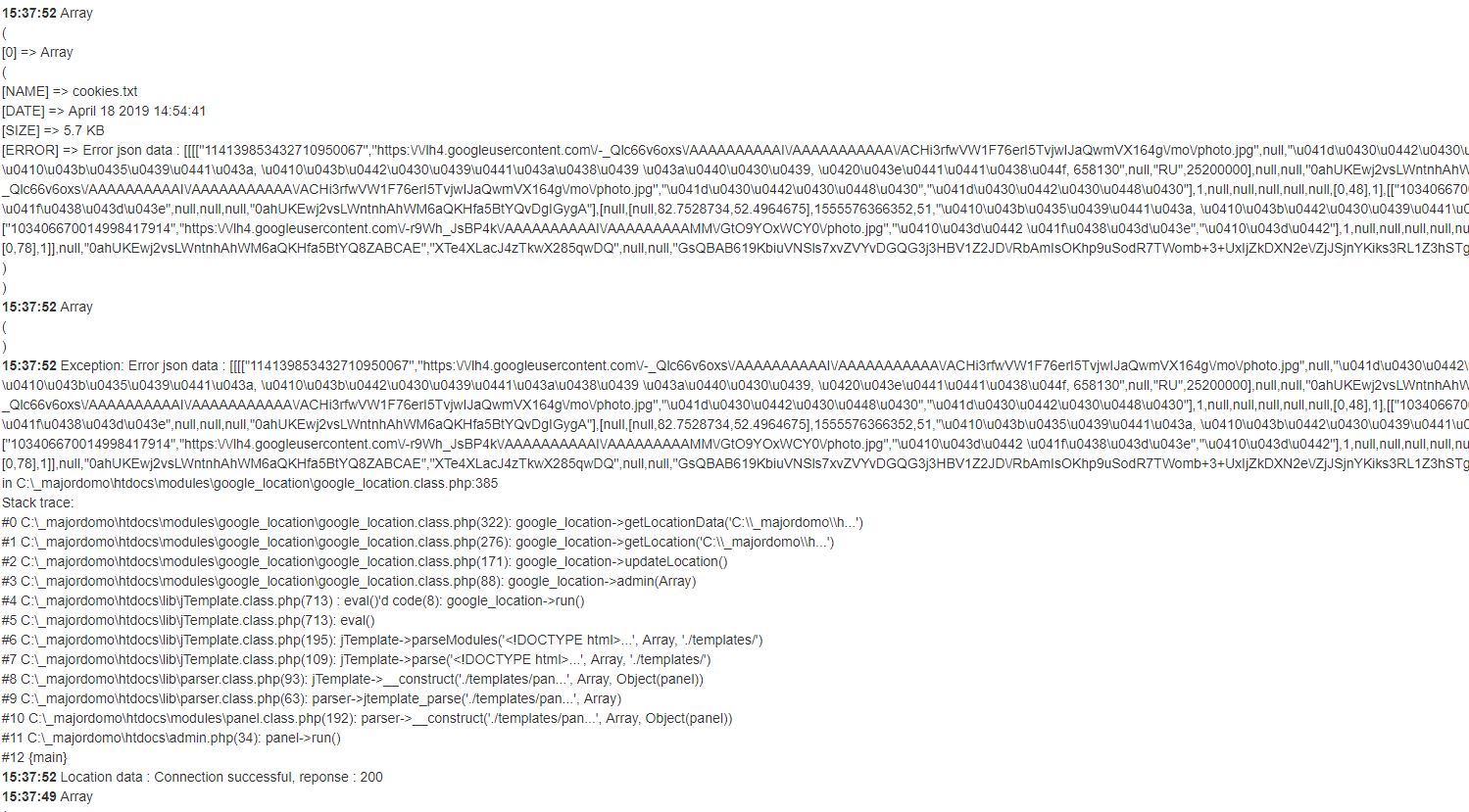

Загрузил куки, я так понимаю что вроде как данные идут, но какая-то ошибка, и данные не отображаются.

Сообщение antpino » Чт апр 18, 2019 12:29 pm
Eraser писал(а):
Чт апр 18, 2019 11:47 am
antpino писал(а):
Чт апр 18, 2019 11:43 am
можно текст данных?
посмотрю что не так обрабатывается
15:37:52 Array
[0] => Array
[NAME] => cookies.txt
[DATE] => April 18 2019 14:54:41
[SIZE] => 5.7 KB
[ERROR] => Error json data : [[[["114139853432710950067","https:\/\/lh4.googleusercontent.com\/-_Qlc66v6oxs\/AAAAAAAAAAI\/AAAAAAAAAAA\/ACHi3rfwVW1F76erI5TvjwIJaQwmVX164g\/mo\/photo.jpg",null,"\u041d\u0430\u0442\u0430\u0448\u0430",null,null,null,"0ahUKEwj2vsLWntnhAhWM6aQKHfa5BtYQvDgIBygA"],[null,[null,82.7749609,52.5055432],1555550149961,16,"\u041f\u043b\u044f\u0436\u043d\u044b\u0439 \u043f\u0435\u0440., 15, \u0410\u043b\u0435\u0439\u0441\u043a, \u0410\u043b\u0442\u0430\u0439\u0441\u043a\u0438\u0439 \u043a\u0440\u0430\u0439, \u0420\u043e\u0441\u0441\u0438\u044f, 658130",null,"RU",25200000],null,null,"0ahUKEwj2vsLWntnhAhWM6aQKHfa5BtYQu4IBCAYoBA",null,["114139853432710950067","https:\/\/lh4.googleusercontent.com\/-_Qlc66v6oxs\/AAAAAAAAAAI\/AAAAAAAAAAA\/ACHi3rfwVW1F76erI5TvjwIJaQwmVX164g\/mo\/photo.jpg","\u041d\u0430\u0442\u0430\u0448\u0430","\u041d\u0430\u0442\u0430\u0448\u0430"],1,null,null,null,null,null,[0,48],1],[["103406670014998417914","https:\/\/lh4.googleusercontent.com\/-r9Wh_JsBP4k\/AAAAAAAAAAI\/AAAAAAAAAMM\/GtO9YOxWCY0\/photo.jpg",null,"\u0410\u043d\u0442 \u041f\u0438\u043d\u043e",null,null,null,"0ahUKEwj2vsLWntnhAhWM6aQKHfa5BtYQvDgIGygA"],[null,[null,82.7528734,52.4964675],1555576366352,51,"\u0410\u043b\u0435\u0439\u0441\u043a, \u0410\u043b\u0442\u0430\u0439\u0441\u043a\u0438\u0439 \u043a\u0440\u0430\u0439, \u0420\u043e\u0441\u0441\u0438\u044f, 658136",null,"RU",25200000],null,null,"0ahUKEwj2vsLWntnhAhWM6aQKHfa5BtYQu4IBCBooBQ",null,["103406670014998417914","https:\/\/lh4.googleusercontent.com\/-r9Wh_JsBP4k\/AAAAAAAAAAI\/AAAAAAAAAMM\/GtO9YOxWCY0\/photo.jpg","\u0410\u043d\u0442 \u041f\u0438\u043d\u043e","\u0410\u043d\u0442"],1,null,null,null,null,null,[0,78],1]],null,"0ahUKEwj2vsLWntnhAhWM6aQKHfa5BtYQ8ZABCAE","XTe4XLacJ4zTkwX285qwDQ",null,null,"GsQBAB619KbiuVNSls7xvZVYvDGQG3j3HBV1Z2JD\/RbAmIsOKhp9uSodR7TWomb+3+UxIjZkDXN2e\/ZjJSjnYKiks3RL1Z3hSTgr0GBa0FNH\/x\/Ft6AoaOJPTgMVgQwRuMKp1qipHFzrG5CL4Ca\/Q2AFqpF3hcMYgWGBO3cwp+8SxKS\/yBNKehObHb9c936H+h\/E8V7tqierzT\/XVQo62mv\/JgHz4m+0rTIKa+7dzXNfOcqeDgobK3kp4w\/262Qy4BLDDt7kVg==",4,1555576670288]
15:37:52 Array
15:37:52 Exception: Error json data : [[[["114139853432710950067","https:\/\/lh4.googleusercontent.com\/-_Qlc66v6oxs\/AAAAAAAAAAI\/AAAAAAAAAAA\/ACHi3rfwVW1F76erI5TvjwIJaQwmVX164g\/mo\/photo.jpg",null,"\u041d\u0430\u0442\u0430\u0448\u0430",null,null,null,"0ahUKEwj2vsLWntnhAhWM6aQKHfa5BtYQvDgIBygA"],[null,[null,82.7749609,52.5055432],1555550149961,16,"\u041f\u043b\u044f\u0436\u043d\u044b\u0439 \u043f\u0435\u0440., 15, \u0410\u043b\u0435\u0439\u0441\u043a, \u0410\u043b\u0442\u0430\u0439\u0441\u043a\u0438\u0439 \u043a\u0440\u0430\u0439, \u0420\u043e\u0441\u0441\u0438\u044f, 658130",null,"RU",25200000],null,null,"0ahUKEwj2vsLWntnhAhWM6aQKHfa5BtYQu4IBCAYoBA",null,["114139853432710950067","https:\/\/lh4.googleusercontent.com\/-_Qlc66v6oxs\/AAAAAAAAAAI\/AAAAAAAAAAA\/ACHi3rfwVW1F76erI5TvjwIJaQwmVX164g\/mo\/photo.jpg","\u041d\u0430\u0442\u0430\u0448\u0430","\u041d\u0430\u0442\u0430\u0448\u0430"],1,null,null,null,null,null,[0,48],1],[["103406670014998417914","https:\/\/lh4.googleusercontent.com\/-r9Wh_JsBP4k\/AAAAAAAAAAI\/AAAAAAAAAMM\/GtO9YOxWCY0\/photo.jpg",null,"\u0410\u043d\u0442 \u041f\u0438\u043d\u043e",null,null,null,"0ahUKEwj2vsLWntnhAhWM6aQKHfa5BtYQvDgIGygA"],[null,[null,82.7528734,52.4964675],1555576366352,51,"\u0410\u043b\u0435\u0439\u0441\u043a, \u0410\u043b\u0442\u0430\u0439\u0441\u043a\u0438\u0439 \u043a\u0440\u0430\u0439, \u0420\u043e\u0441\u0441\u0438\u044f, 658136",null,"RU",25200000],null,null,"0ahUKEwj2vsLWntnhAhWM6aQKHfa5BtYQu4IBCBooBQ",null,["103406670014998417914","https:\/\/lh4.googleusercontent.com\/-r9Wh_JsBP4k\/AAAAAAAAAAI\/AAAAAAAAAMM\/GtO9YOxWCY0\/photo.jpg","\u0410\u043d\u0442 \u041f\u0438\u043d\u043e","\u0410\u043d\u0442"],1,null,null,null,null,null,[0,78],1]],null,"0ahUKEwj2vsLWntnhAhWM6aQKHfa5BtYQ8ZABCAE","XTe4XLacJ4zTkwX285qwDQ",null,null,"GsQBAB619KbiuVNSls7xvZVYvDGQG3j3HBV1Z2JD\/RbAmIsOKhp9uSodR7TWomb+3+UxIjZkDXN2e\/ZjJSjnYKiks3RL1Z3hSTgr0GBa0FNH\/x\/Ft6AoaOJPTgMVgQwRuMKp1qipHFzrG5CL4Ca\/Q2AFqpF3hcMYgWGBO3cwp+8SxKS\/yBNKehObHb9c936H+h\/E8V7tqierzT\/XVQo62mv\/JgHz4m+0rTIKa+7dzXNfOcqeDgobK3kp4w\/262Qy4BLDDt7kVg==",4,1555576670288] in C:\_majordomo\htdocs\modules\google_location\google_location.class.php:385
Stack trace:
#0 C:\_majordomo\htdocs\modules\google_location\google_location.class.php(322): google_location->getLocationData('C:\\_majordomo\\h...')
#1 C:\_majordomo\htdocs\modules\google_location\google_location.class.php(276): google_location->getLocation('C:\\_majordomo\\h...')
#2 C:\_majordomo\htdocs\modules\google_location\google_location.class.php(171): google_location->updateLocation()
#3 C:\_majordomo\htdocs\modules\google_location\google_location.class.php(88): google_location->admin(Array)
#4 C:\_majordomo\htdocs\lib\jTemplate.class.php(713) : eval()'d code(8): google_location->run()
#5 C:\_majordomo\htdocs\lib\jTemplate.class.php(713): eval()
#6 C:\_majordomo\htdocs\lib\jTemplate.class.php(195): jTemplate->parseModules('<!DOCTYPE html>...', Array, './templates/')
#7 C:\_majordomo\htdocs\lib\jTemplate.class.php(109): jTemplate->parse('<!DOCTYPE html>...', Array, './templates/')
#8 C:\_majordomo\htdocs\lib\parser.class.php(93): jTemplate->__construct('./templates/pan...', Array, Object(panel))
#9 C:\_majordomo\htdocs\lib\parser.class.php(63): parser->jtemplate_parse('./templates/pan...', Array)
#10 C:\_majordomo\htdocs\modules\panel.class.php(192): parser->__construct('./templates/pan...', Array, Object(panel))
#11 C:\_majordomo\htdocs\admin.php(34): panel->run()
#12 {main}
15:37:52 Location data : Connection successful, reponse : 200
Последний раз редактировалось antpino Чт апр 18, 2019 5:41 pm, всего редактировалось 1 раз.

Сообщение Eraser » Чт апр 18, 2019 12:56 pm
можно текст данных?
15:37:52 Array
[0] => Array
[SIZE] => 5.7 KB
15:37:52 Array
Stack trace:
#12 {main}
залил обновление

17:26:37 delete cookie cookies.txt
залил обновление, дополнительное логирование данных после парсинга json
видно хотябы будет что пришло

данные после обновления
21:35:58 Array
[0] => Array
[NAME] => cookies (1).txt
[DATE] => April 18 2019 21:35:48
[SIZE] => 2.77 KB
[ERROR] =>
21:35:58 Array
21:35:58 Array
[0] => Array
[0] => Array
[0] => Array
[0] => 114139853432710950067
[1] => https://lh4.googleusercontent.com/-_Qlc66v6oxs/AAAAAAAAAAI/AAAAAAAAAAA/ACHi3rfwVW1F76erI5TvjwIJaQwmVX164g/mo/photo.jpg
[2] =>
[3] => Наташа
[4] =>
[5] =>
[6] =>
[7] => 0ahUKEwjf5dXb7tnhAhWSLlAKHZppBR8QvDgIBygA
[1] => Array
[0] =>
[1] => Array
[0] =>
[1] => 82.7749609
[2] => 52.5055432
[2] => 1555550149961
[3] => 16
[4] => Пляжный пер., Алейск, Алтайский край, Россия, 658130
[5] =>
[6] => RU
[7] => 25200000
[2] =>
[3] =>
[4] => 0ahUKEwjf5dXb7tnhAhWSLlAKHZppBR8Qu4IBCAYoBA
[5] =>
[6] => Array
[2] => Наташа
[3] => Наташа
[7] => 1
[8] =>
[9] =>
[10] =>
[11] =>
[12] =>
[13] => Array
[0] => 0
[1] => 48
[14] => 1
[1] => Array
[0] => Array
[0] => 103406670014998417914
[1] => https://lh4.googleusercontent.com/-r9Wh_JsBP4k/AAAAAAAAAAI/AAAAAAAAAMM/GtO9YOxWCY0/photo.jpg
[2] =>
[3] => Ант Пино
[4] =>
[5] =>
[6] =>
[7] => 0ahUKEwjf5dXb7tnhAhWSLlAKHZppBR8QvDgIGygA
[1] => Array
[0] =>
[1] => Array
[0] =>
[1] => 82.7752391
[2] => 52.5055445
[2] => 1555598082710
[3] => 33
[4] => Алейск, Алтайский край, Россия, 658130
[5] =>
[6] => RU
[7] => 25200000
[2] =>
[3] =>
[4] => 0ahUKEwjf5dXb7tnhAhWSLlAKHZppBR8Qu4IBCBooBQ
[5] =>
[6] => Array
[2] => Ант Пино
[3] => Ант
[7] => 0
[8] =>
[9] =>
[10] =>
[11] =>
[12] =>
[13] => Array
[0] => 0
[1] => 62
[14] => 3
[1] =>
[2] => 0ahUKEwjf5dXb7tnhAhWSLlAKHZppBR8Q8ZABCAE
[3] => S4u4XJ-UEZLdwAKa05X4AQ
[4] =>
[5] =>
[6] => GpUBAB619KYq30fLEqUuJ0FvYKYOkc7zctCJ/I/5nTDdc1xJbRmKJeKpM2qP6oXhi8abdZmaWimVSm4miBypyis2Y8R8+8s0gTRWWmlxJFPH0OD4kwODDxIUbv8JYV/iaMLFbk7YhGO1uzZFvpGYdDBjFF0MYBQnlATmzrD6kvHKQ9Q9/ADqU8/d89sg3k6NBXUDK7gp4x4=
[7] => 4
[8] => 1555598155908
21:35:58 Location data : Connection successful, reponse : 200
