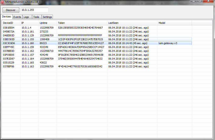

Log работает:
[10:14:43] [10.0.1.160:54321] RAW: 213100200000000003C3C6D600015C87CC1EAB1F44F1CEF76768D7851CED4127
[10:14:43] pktLen=32, DeviceID=03C3C6D6, Uptime=89223, Token=CC1EAB1F44F1CEF76768D7851CED4127
[10:14:43] ----------------------------------------------------------- 80
[10:14:43] >>> 213100500000000003C3C6D600015C8737CBE6C715761EA5A56B6E1A9F22C221A80BBE0DE05EC726D5BB7A5F561B500E63FFF53A92B8D3D4AF27464E7AAD4B2818B7F3C3FEBDE42D19EA9AAC7A8F7239
[10:14:43] ----------------------------------------------------------- 544
[10:14:43] [10.0.1.160:54321] RAW: 213102200000000003C3C6D600015C87A8E345DE76DFF1F55B7A0F8B3A34BC050D4817645F9B893F94FEB40090FF8DAF66E9506B7BA660C868A0C450F5AAA8DF2C9F503DE21FACB1873B1AEF20FE893B2D1FAEDD2CEFF613F150530FFFF3A67DE7E2B7C65F75299B64AC0456E2507A47E0B6A15AD7D9972EAA5E16EA4228DE6118601E1C93FB5B5B5E20137CEA798DDFA72B9C522C0EA91FB08174F0508B2F428E8A6C9406D2866FF11BB0E2070B3F4F866A617BED0B71E527599F3A7D4F7F44743A5B56F87AC912E0609C657746C8C17336E8B035D60A0456D3378C45D4C9F1B88A99D9AE6B9BC7801D6DAAADB240C89B42D71560E4EAD54AD354B4477137C19880583CFF70988339DD0D09A8270F7B798F257E44FBF4F41A85E194DADDE9FF92CE9204646EF81FD88497DEA98E619BB1980E5D13CEC6C592022DACBC726980E9A72F35623213655B7E94859DBE2F4390A43DE807C1497B0C5CD1D816ACBA4813FFFC4F2027D5FA86557DE2241578A9EDAE1D36A9FFC3C21C57DF7AA62240AF71B09C04C4D6ACB352F5F468FA8FE5F5B87220AD12D27BF05E22F6B673D1D6D959746DEB524A379A28F0686268132D4F714E705C1888948105E8869AFC902D4F9906D743F11CF72CF73D406730969CF3FB12B792887E614CEB37E854FA48D9529E681F87A9A14D3340682FB240EA17CE6F9E4932CDF2B06DF060074D8A5434A62D18C5D410AE587E27C0597DF8FA52DE186BFE109A1792F8D0048594BE789445
[10:14:43] pktLen=544, DeviceID=03C3C6D6, Uptime=89223, CheckSum=A8E345DE76DFF1F55B7A0F8B3A34BC05
[10:14:43] Data = 0D4817645F9B893F94FEB40090FF8DAF66E9506B7BA660C868A0C450F5AAA8DF2C9F503DE21FACB1873B1AEF20FE893B2D1FAEDD2CEFF613F150530FFFF3A67DE7E2B7C65F75299B64AC0456E2507A47E0B6A15AD7D9972EAA5E16EA4228DE6118601E1C93FB5B5B5E20137CEA798DDFA72B9C522C0EA91FB08174F0508B2F428E8A6C9406D2866FF11BB0E2070B3F4F866A617BED0B71E527599F3A7D4F7F44743A5B56F87AC912E0609C657746C8C17336E8B035D60A0456D3378C45D4C9F1B88A99D9AE6B9BC7801D6DAAADB240C89B42D71560E4EAD54AD354B4477137C19880583CFF70988339DD0D09A8270F7B798F257E44FBF4F41A85E194DADDE9FF92CE9204646EF81FD88497DEA98E619BB1980E5D13CEC6C592022DACBC726980E9A72F35623213655B7E94859DBE2F4390A43DE807C1497B0C5CD1D816ACBA4813FFFC4F2027D5FA86557DE2241578A9EDAE1D36A9FFC3C21C57DF7AA62240AF71B09C04C4D6ACB352F5F468FA8FE5F5B87220AD12D27BF05E22F6B673D1D6D959746DEB524A379A28F0686268132D4F714E705C1888948105E8869AFC902D4F9906D743F11CF72CF73D406730969CF3FB12B792887E614CEB37E854FA48D9529E681F87A9A14D3340682FB240EA17CE6F9E4932CDF2B06DF060074D8A5434A62D18C5D410AE587E27C0597DF8FA52DE186BFE109A1792F8D0048594BE789445
[10:14:43] DecryptedData = {"result":{"life":89223,"cfg_time":0,"token":"cc1eab1f44f1cef76768d7851ced4127","mac":"34:CE:00:FA:79:4E","fw_ver":"1.4.1_153","hw_ver":"MW300","model":"lumi.gateway.v3","mcu_fw_ver":"0143","wifi_fw_ver":"SD878x-14.76.36.p84-702.1.0-WM","ap":{"rssi":-61,"ssid":"chibis","bssid":"90:72:40:16:77:1E"},"netif":{"localIp":"10.0.1.160","mask":"255.255.255.0","gw":"10.0.1.1","gw_mac":"90:72:40:04:E4:1C"},"mmfree":168856,"ot":"ott","otu_stat":[12,9,2315,81,2103,1400],"ott_stat":[5, 5, 349, 3462]},"id":1}
[10:19:38] ----------------------------------------------------------- 32
[10:19:38] >>> 21310020FFFFFFFFFFFFFFFFFFFFFFFFFFFFFFFFFFFFFFFFFFFFFFFFFFFFFFFF
скриншот девайсы:
Добавлено: Пт апр 06, 2018 10:38 am
chibis писал(а): Пт апр 06, 2018 10:23 amLog работает:
Вкладка Events нужна.
