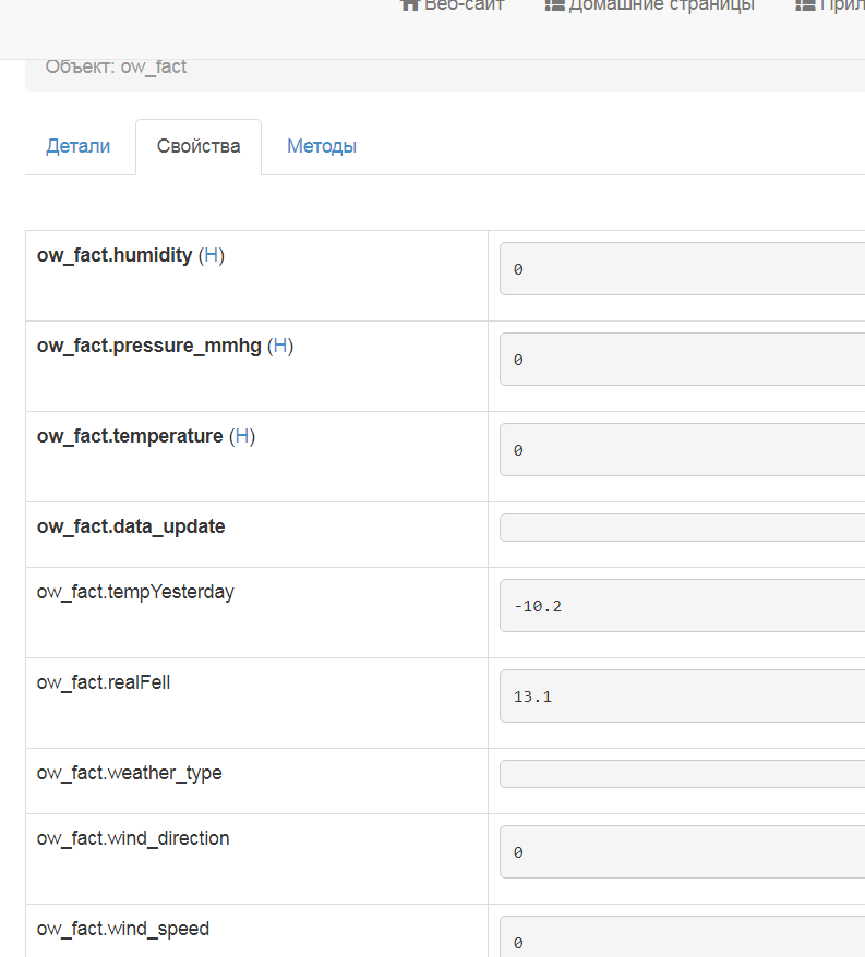

еще такой вариант в 21
2018-03-14 20:00:03
{"coord":{"lon":59.97,"lat":57.92},"weather":[{"id":802,"main":"Clouds","description":"слегка облачно","icon":"03n"}],"base":"stations","main":{"temp":-4.11,"pressure":997.16,"humidity":74,"temp_min":-4.11,"temp_max":-4.11,"sea_level":1027.76,"grnd_level":997.16},"wind":{"speed":5.22,"deg":254.001},"clouds":{"all":32},"dt":1521039492,"sys":{"message":0.0038,"country":"RU","sunrise":1520993879,"sunset":1521036095},"id":520494,"name":"Nizhniy Tagil","cod":200}
2018-03-14 21:00:08
т.е. вообще пустая строка
в логе
21:00:08 0.91158600 GetURL to http://api.openweathermap.org/data/2.5/ ... #40;source require) finished with error:
Resolving timed out after 5515 milliseconds
{"url":"http:\/\/api.openweathermap.org\/data\/2.5\/weather?id=520494&mode=json&units=metric&lang=ru&appid=appid","content_type":null,"http_code":0,"header_size":0,"request_size":0,"filetime":-1,"ssl_verify_result":0,"redirect_count":0,"total_time":5.51475,"namelookup_time":0,"connect_time":0,"pretransfer_time":0,"size_upload":0,"size_download":0,"speed_download":0,"speed_upload":0,"download_content_length":-1,"upload_content_length":-1,"starttransfer_time":0,"redirect_time":0,"redirect_url":"","primary_ip":"","certinfo":[],"primary_port":0,"local_ip":"","local_port":0}
на 14.03.2018 19:58:12 +05 2018
в свойства ничего не записало
