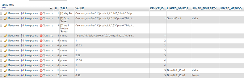

S1 очень странно пишется в базу. Посмотри
Сенсор двери:
{"sensor_number":2,"product_id":49,"photo":"http:\/\/jp-clouddb.ibroadlink.com\/sensor\/picture\/49.png","location":"","product_type":"Door Sensor","status":0,"status_val":"\u0417\u0430\u043a\u0440\u044b\u0442\u043e","batterylow":0,"tamper":0,"product_name":"\u0000\u0000\u0000\u0000\u0000","device_id":1536295217,"s1_pwd":"95a1faf1","armFull":false,"armPart":false,"zone":"Not specified","delay_online":45,"delay_battery":0,"delay_tamper_switch":0,"delay_detect":0}

Sapizdullin
nick7zmail писал(а):Так и должно быть. Это json формат.
Но не работает! :lol:
