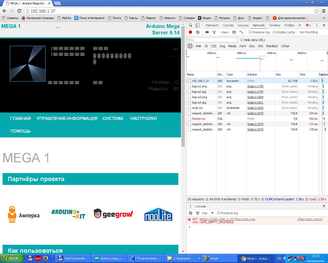

denis68
Всем доброго времени суток.
Alex огромное спасибо за проделанную работу.
Очень хочется разобраться с AMS duo+w5100, третий день не могу запустить.
Все прошил, могу только попинговать, сайт не открывается.
Подскажите что может быть???
Modul SD...
SD started... OK
index.htm... found
started
Modul RTC...
Waiting for NTP sync...
2016-04-27 20:07:02 started
2016-04-27 20:07:02 Modul Server... started
2016-04-27 20:07:02 Modul Timers... started
2016-04-27 20:07:02 Modul SD Info... started
2016-04-27 20:07:02 Modul PIR's... started
2016-04-27 20:07:02 Modul Contacts... started
2016-04-27 20:07:02 Modul Temperature...
2016-04-27 20:07:02 Parasite power OFF
2016-04-27 20:07:02 Found 0 devices
2016-04-27 20:07:02 #0: 0 0 0 0 0 0 0 tempSTR
2016-04-27 20:07:02 #1: 0 0 0 0 0 0 0 tempHOM
2016-04-27 20:07:02 #2: 0 0 0 0 0 0 0 tempWRM
2016-04-27 20:07:03 Modul Electro... started
2016-04-27 20:07:03 Modul nooLite... started
2016-04-27 20:07:03 GLOBAL Init DONE
2016-04-27 20:07:03 AMS WORK
2016-04-27 20:07:03 tempSTR: ID problem or not present
2016-04-27 20:07:03 tempHOM: ID problem or not present
2016-04-27 20:07:03 tempWRM: ID problem or not present
2016-04-27 20:07:04 tempSTR: ID problem or not present
2016-04-27 20:07:04 tempHOM: ID problem or not present
2016-04-27 20:07:04 tempWRM: ID problem or not present
2016-04-27 20:07:05 tempSTR: ID problem or not present
2016-04-27 20:07:05 tempHOM: ID problem or not present
2016-04-27 20:07:05 tempWRM: ID problem or not present
2016-04-27 20:07:06 tempSTR: ID problem or not present
2016-04-27 20:07:06 tempHOM: ID problem or not present
2016-04-27 20:07:06 tempWRM: ID problem or not present
2016-04-27 20:07:07 tempSTR: ID problem or not present
2016-04-27 20:07:07 tempHOM: ID problem or not present
2016-04-27 20:07:07 tempWRM: ID problem or not present
2016-04-27 20:07:08 tempSTR: ID problem or not present
2016-04-27 20:07:08 tempHOM: ID problem or not present
2016-04-27 20:07:08 tempWRM: ID problem or not present
2016-04-27 20:07:09 tempSTR: ID problem or not present
2016-04-27 20:07:09 tempHOM: ID problem or not present
2016-04-27 20:07:09 tempWRM: ID problem or not present
2016-04-27 20:07:10 tempSTR: ID problem or not present
2016-04-27 20:07:10 tempHOM: ID problem or not present
2016-04-27 20:07:10 tempWRM: ID problem or not present
2016-04-27 20:07:11 tempSTR: ID problem or not present
2016-04-27 20:07:11 tempHOM: ID problem or not present
2016-04-27 20:07:11 tempWRM: ID problem or not present
2016-04-27 20:12:01 tempSTR: ID problem or not present
2016-04-27 20:12:01 tempHOM: ID problem or not present
2016-04-27 20:12:01 tempWRM: ID problem or not present
2016-04-27 20:17:01 tempSTR: ID problem or not present
Ну сервер у вас запускается судя по логу...может sd-карту не видит, и не может открыть содержимое? Либо на карте структура каталогов неправильная... Попробуйте отформатить её, и снова данные залить.
