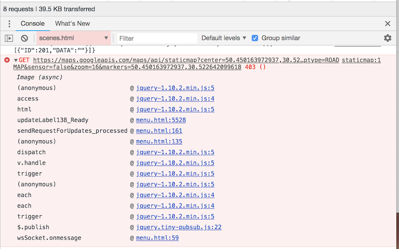

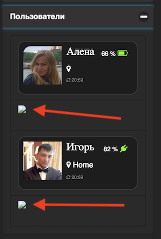

Недавно заметил что в меню под ползователями перестала отображаться карта местоположение пользователя.
И на странице появились ошибки
Failed to load resource: the server responded with a status of 403 (Forbidden)
maps.googleapis.com/maps/api/staticmap?center=50.434640394856,30.516054898927&size=300x300&maptype=ROADMAP&sensor=false&zoom=16&markers=50.434640394856,30.516054898927:1 Failed to load resource: the server responded with a status of 403 ()
jquery-1.10.2.min.js:6 [Deprecation] Synchronous XMLHttpRequest on the main thread is deprecated because of its detrimental effects to the end user's experience. For more help, check https://xhr.spec.whatwg.org/.
send @ jquery-1.10.2.min.js:6
maps.googleapis.com/maps/api/staticmap?center=50.450163972937,30.522642099618&size=300x300&maptype=ROADMAP&sensor=false&zoom=16&markers=50.450163972937,30.522642099618:1 Failed to load resource: the server responded with a status of 403 ()
maps.googleapis.com/maps/api/staticmap?center=50.471368791333,30.514985996496&size=300x300&maptype=ROADMAP&sensor=false&zoom=16&markers=50.471368791333,30.514985996496:1 Failed to load resource: the server responded with a status of 403 (Forbidden)
maps.googleapis.com/maps/api/staticmap?center=50.464365461688,30.515721218061&size=300x300&maptype=ROADMAP&sensor=false&zoom=16&markers=50.464365461688,30.515721218061:1 Failed to load resource: the server responded with a status of 403 ()
2staticmap:1 Failed to load resource: the server responded with a status of 403 ()
staticmap:1 Failed to load resource: the server responded with a status of 403 (Forbidden)
И в х-ray
16:33:31 0.29318500  URL: http://10.0.1.5/ - Uncaught SyntaxError: Unexpected end of JSON input; line: 1
16:33:54 0.06796900  URL: http://10.0.1.5/ - Uncaught TypeError: Cannot read property 'appendChild' of null; line: 304
16:33:56 0.45183600  URL: http://10.0.1.5/menu.html - Uncaught TypeError: Cannot read property 'appendChild' of null; line: 5926
16:34:39 0.63786200  URL: http://10.0.1.5/ - Uncaught TypeError: Cannot read property 'appendChild' of null; line: 304

РКН тут точно не причем )) я живу в Украине ). У меня все началось с телефона, в телефоне то отображалось , то не отображалось, с компьютера всегда отображалось, а сейчас везде пропало. Такое впечатление что гугл требует API ключ.
Re: Ещё немного обновлений
Добавлено: Вс июн 17, 2018 12:37 am
igorewa писал(а): Вс июн 17, 2018 12:34 amТакое впечатление что гугл требует API ключ.
Судя по 403 ошибке от сервера гугла, очень на то похоже.

Да так и есть, везде ( модуль GPS, Ideveces и в меню )
The Google Maps API server rejected your request. You must use an API key to authenticate each request to Google Maps Platform APIs. For additional information, please refer to http://g.co/dev/maps-no-account
В модуль GPS в настройках внес ключ и карта заработала, Может кто подскажет как скормить API key для остальной для меню и модуля Ideveces ?
