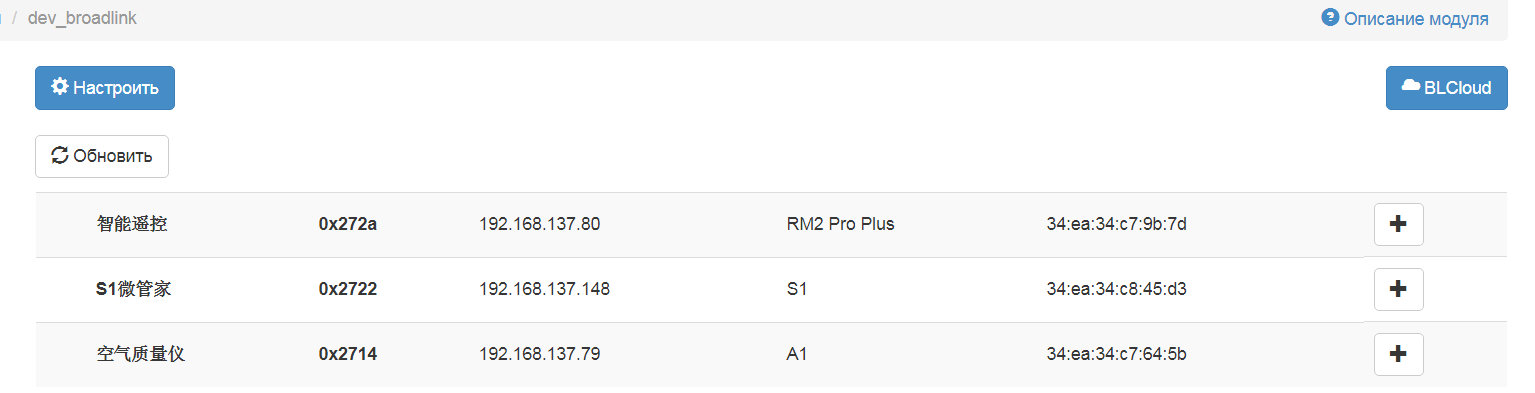

akemals писал(а): hi.
thanks for quick answer..
i can add s1c my module but i did not make settings. so i cant use this item.
in the evening, i will screen shot my page about this problem.
i can add TC2 button1 (ON) and button2(OFF) with broadlink rm.but i want to add only one button same sp mini.
1) Where is screenshots?
2) run dev_broadlink cycle/service on x-ray page. On data page must adds some data.
3) for 1 button (switch) see that manual
https://majordomo.smartliving.ru/forum/ ... 727#p45727
or that
https://majordomo.smartliving.ru/forum/ ... 054#p54054 (At this page is not entirely correct. Methods should not be turnon/turnoff, but statusUpdate. And the code is a bit different. I will corrects, as there will be time.)

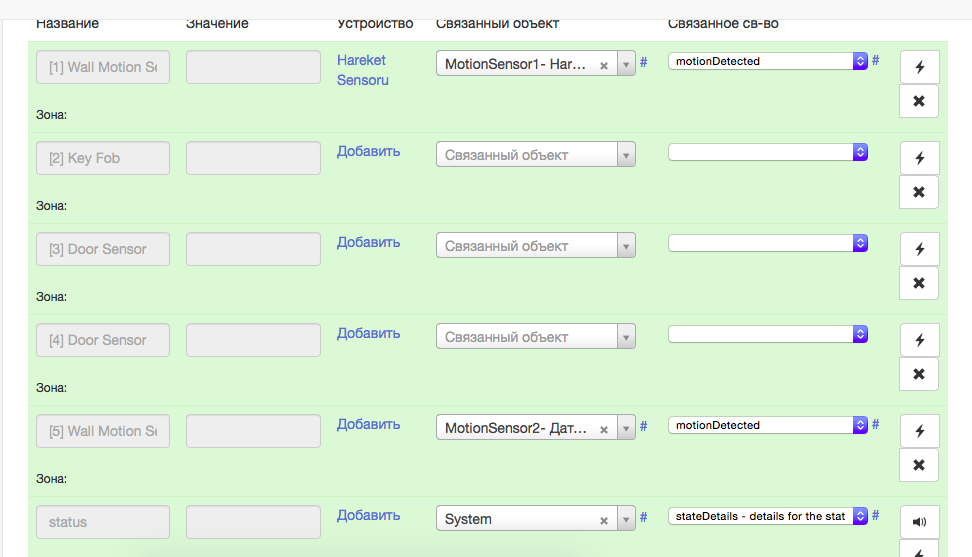

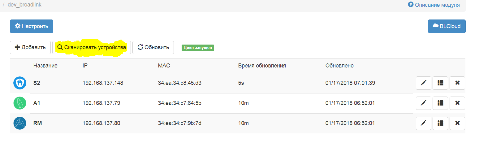

and how can i cancel <startx< ? because my electric not good.
Последний раз редактировалось akemals Ср янв 17, 2018 3:00 pm, всего редактировалось 2 раза.
Re: [Модуль] Broadlink
Эт к чему скрины?
к выше, значений нет, что с циклом, что с определением устройства s1
