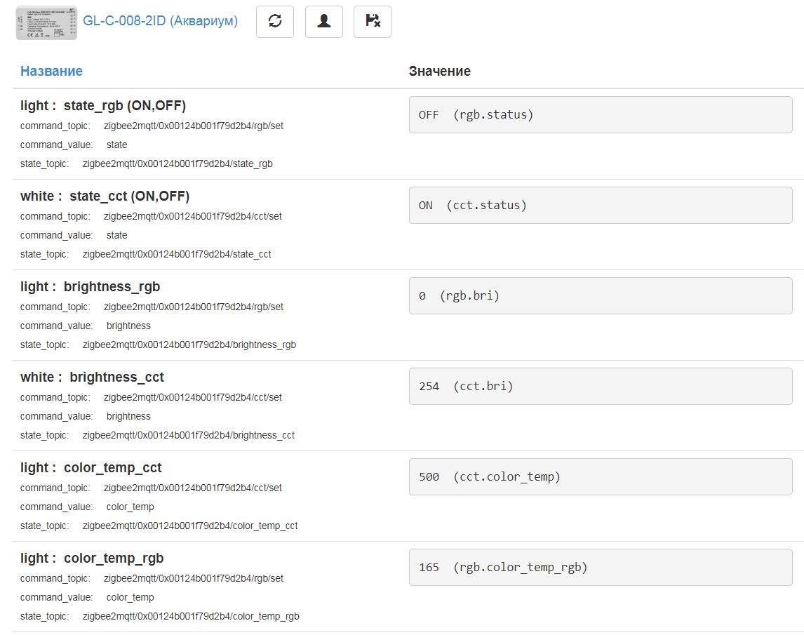

Добавьте пожалуйста Gledopto GL-C-008-2ID.
https://www.zigbee2mqtt.io/devices/GL-C-008-2ID.html

2id не тестировал, пришлите пож-та скриншоты подключенного устройства.

directman66 писал(а): Сб июн 13, 2020 10:04 pm 2id не тестировал, пришлите пож-та скриншоты подключенного устройства.
Добавил сам, оказалось не сложно))
В database1.inc добавил
$par1['zigbeeModel'] = 'GL-C-008-2ID';
$par1['model'] = "GL-C-008-2ID";
$par1['vendor'] = "Gledopto";
$par1['type'] = "dimmer";
$par1['description'] = "Zigbee LED controller RGB + CCT / RGBW / WWCW / Dimmer";
$par1['supports'] = "generic.light_onoff_brightness_colortemp_colorxy";
$par1['extend'] = "";
$par1['fromZigbee'] = "";
$par1['toZigbee'] = "";
SQLInsert('zigbee2mqtt_devices_list', $par1);
в database2.inc
//GL-C-008-2ID;
$par2['zigbeeModel'] = 'GL-C-008-2ID';
$par2['type'] = "light";
$par2['state_topic'] =  "<Z2M_PATH>/<FRIENDLY_NAME>";
$par2['availability_topic'] = "<Z2M_PATH>/bridge/state";
$par2['brightness'] = "true";
$par2['xy'] = "true";
$par2['command_topic'] = "<Z2M_PATH>/<FRIENDLY_NAME>/rgb/set"  ;
$par2['payload_on'] = "ON";
$par2['payload_off'] = "OFF";
$par2['value_template'] = "state_rgb";
$par2['json_attributes'] = "";
$par2['device_class'] = "";
$par2['unit_of_measurement'] = "";
$par2['color_temp'] = "true";
$par2['command_value'] = "state";
SQLInsert('zigbee2mqtt_devices_command', $par2);
//GL-C-008-2ID;
$par2['type'] = "white";
$par2['command_topic'] = "<Z2M_PATH>/<FRIENDLY_NAME>/cct/set";
$par2['value_template'] = "state_cct";
$par2['color_temp'] = "";
//GL-C-008-2ID;
$par2['payload_on'] = "";
$par2['payload_off'] = "";
$par2['value_template'] = "brightness_rgb";
$par2['command_value'] = "brightness";
//GL-C-008-2ID;
$par2['xy'] = "false";
$par2['command_topic'] = "<Z2M_PATH>/<FRIENDLY_NAME>/cct/set"  ;
$par2['value_template'] = "brightness_cct";
//GL-C-008-2ID;
$par2['value_template'] = "color_temp_cct";
$par2['command_value'] = "color_temp";
//GL-C-008-2ID;
$par2['value_template'] = "color_temp_rgb";
Еще вопрос можно ли как то передавать цвет в hex, просто в свойство привязанное к z2m, без дополнительных методов?
