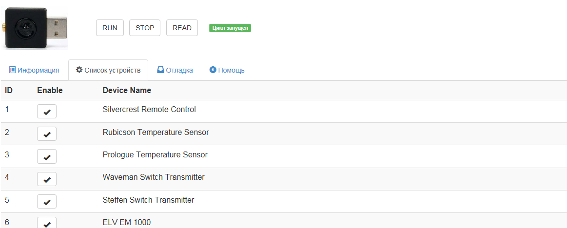

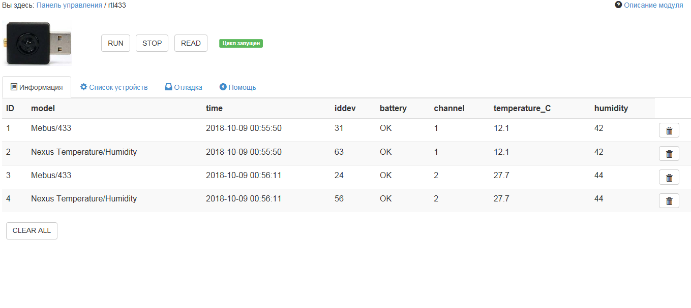

Сообщение directman66 » Вт окт 09, 2018 1:28 pm
Потихоньку модуль обрастает функционалом
Кстати, список поддерживаемых устройств впечатляет.
[01] Silvercrest Remote Control
[02] Rubicson Temperature Sensor
[03] Prologue Temperature Sensor
[04] Waveman Switch Transmitter
[05]* Steffen Switch Transmitter
[06]* ELV EM 1000
[07]* ELV WS 2000
[08] LaCrosse TX Temperature / Humidity Sensor
[09]* Template decoder
[10]* Acurite 896 Rain Gauge
[11] Acurite 609TXC Temperature and Humidity Sensor
[12] Oregon Scientific Weather Sensor
[13]* Mebus 433
[14]* Intertechno 433
[15] KlikAanKlikUit Wireless Switch
[16] AlectoV1 Weather Sensor (Alecto WS3500 WS4500 Ventus W155/W044 Oregon)
[17] Cardin S466-TX2
[18] Fine Offset Electronics, WH2, WH5, Telldus Temperature/Humidity/Rain Sensor
[19] Nexus Temperature & Humidity Sensor
[20] Ambient Weather Temperature Sensor
[21] Calibeur RF-104 Sensor
[22]* X10 RF
[23] DSC Security Contact
[24]* Brennenstuhl RCS 2044
[25] GT-WT-02 Sensor
[26] Danfoss CFR Thermostat
[27]* Energy Count 3000 (868.3 MHz)
[28]* Valeo Car Key
[29] Chuango Security Technology
[30] Generic Remote SC226x EV1527
[31] TFA-Twin-Plus-30.3049 and Ea2 BL999
[32] Fine Offset Electronics WH1080/WH3080 Weather Station
[33] WT450
[34] LaCrosse WS-2310 Weather Station
[35] Esperanza EWS
[36] Efergy e2 classic
[37]* Inovalley kw9015b, TFA Dostmann 30.3161 (Rain and temperature sensor)
[38] Generic temperature sensor 1
[39] WG-PB12V1
[40] Acurite 592TXR Temp/Humidity, 5n1 Weather Station, 6045 Lightning
[41] Acurite 986 Refrigerator / Freezer Thermometer
[42] HIDEKI TS04 Temperature, Humidity, Wind and Rain Sensor
[43] Watchman Sonic / Apollo Ultrasonic / Beckett Rocket oil tank monitor
[44] CurrentCost Current Sensor
[45] emonTx OpenEnergyMonitor
[46] HT680 Remote control
[47] S3318P Temperature & Humidity Sensor
[48] Akhan 100F14 remote keyless entry
[49] Quhwa
[50] OSv1 Temperature Sensor
[51] Proove
[52] Bresser Thermo-/Hygro-Sensor 3CH
[53] Springfield Temperature and Soil Moisture
[54] Oregon Scientific SL109H Remote Thermal Hygro Sensor
[55] Acurite 606TX Temperature Sensor
[56] TFA pool temperature sensor
[57] Kedsum Temperature & Humidity Sensor
[58] blyss DC5-UK-WH (433.92 MHz)
[59] Steelmate TPMS
[60] Schrader TPMS
[61]* LightwaveRF
[62] Elro DB286A Doorbell
[63] Efergy Optical
[64] Honda Car Key
[65]* Template decoder
[66]* Template decoder
[67] Radiohead ASK
[68] Kerui PIR Sensor
[69] Fine Offset WH1050 Weather Station
[70] Honeywell Door/Window Sensor
[71] Maverick ET-732/733 BBQ Sensor
[72]* RF-tech
[73] LaCrosse TX141-Bv2/TX141TH-Bv2 sensor
[74] Acurite 00275rm,00276rm Temp/Humidity with optional probe
[75] LaCrosse TX35DTH-IT, TFA Dostmann 30.3155 Temperature/Humidity sensor
[76] LaCrosse TX29IT Temperature sensor
[77] Vaillant calorMatic 340f Central Heating Control
[78] Fine Offset Electronics, WH25, WH24, HP1000 Temperature/Humidity/Pressure Sensor
[79] Fine Offset Electronics, WH0530 Temperature/Rain Sensor
[80] IBIS beacon
[81] Oil Ultrasonic STANDARD FSK
[82] Citroen TPMS
[83] Oil Ultrasonic STANDARD ASK
[84] Thermopro TP11 Thermometer
[85] Solight TE44
[86] Wireless Smoke and Heat Detector GS 558
[87] Generic wireless motion sensor
[88] Toyota TPMS
[89] Ford TPMS
[90] Renault TPMS
[91]* inFactory
[92] FT-004-B Temperature Sensor
[93] Ford Car Key
[94] Philips outdoor temperature sensor
[95] Schrader TPMS EG53MA4
[96] Nexa
[97] Thermopro TP08/TP12 thermometer
[98] GE Color Effects
[99] X10 Security
[100] Interlogix GE UTC Security Devices
[101]* Dish remote 6.3
[102]* SimpliSafe Home Security System (May require disabling automatic gain for KeyPad decodes)
[103] Sensible Living Mini-Plant Moisture Sensor
[104]* Wireless M-Bus, Mode C&T, 100kbps (-f 868950000 -s 1200000)
[105]* Wireless M-Bus, Mode S, 32.768kbps (-f 868300000 -s 1000000)
[106]* Wireless M-Bus, Mode R, 4.8kbps (-f 868330000)
[107]* Wireless M-Bus, Mode F, 2.4kbps
[108] WS Temperature Sensor
[109] WT0124 Pool Thermometer
