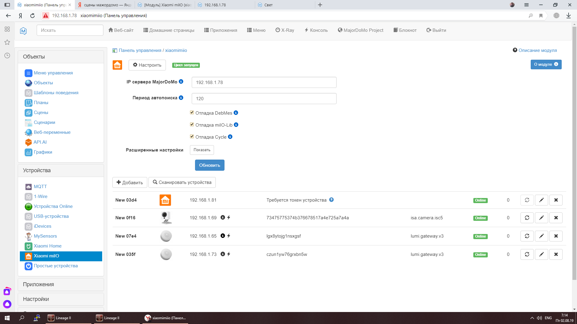

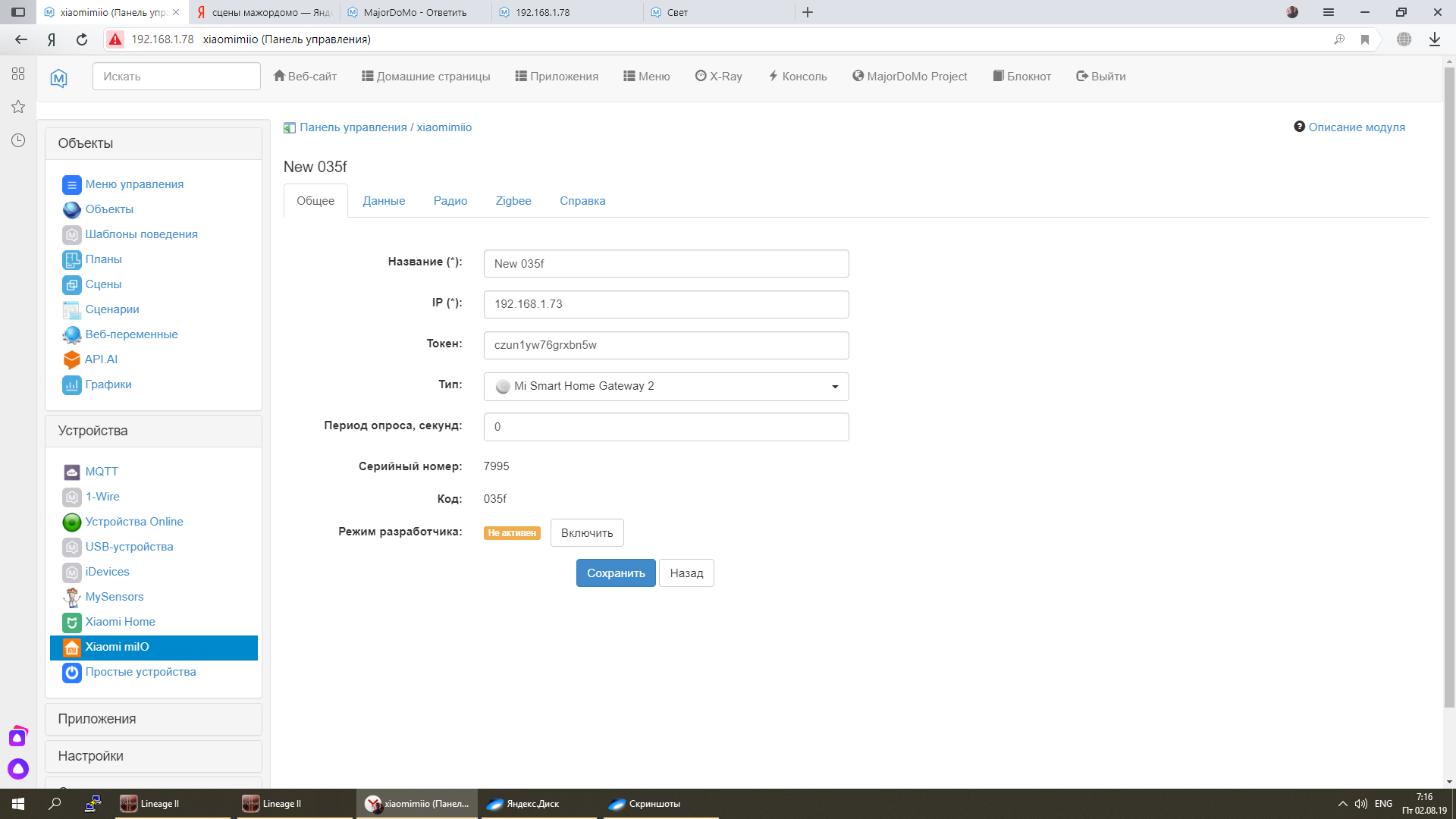

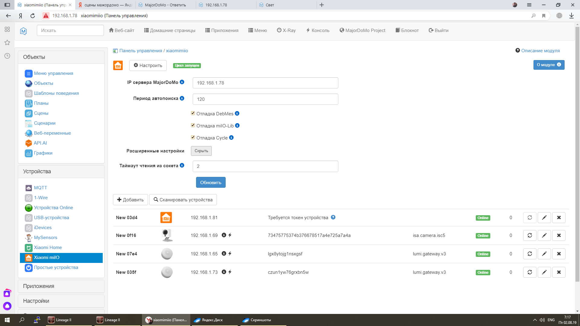

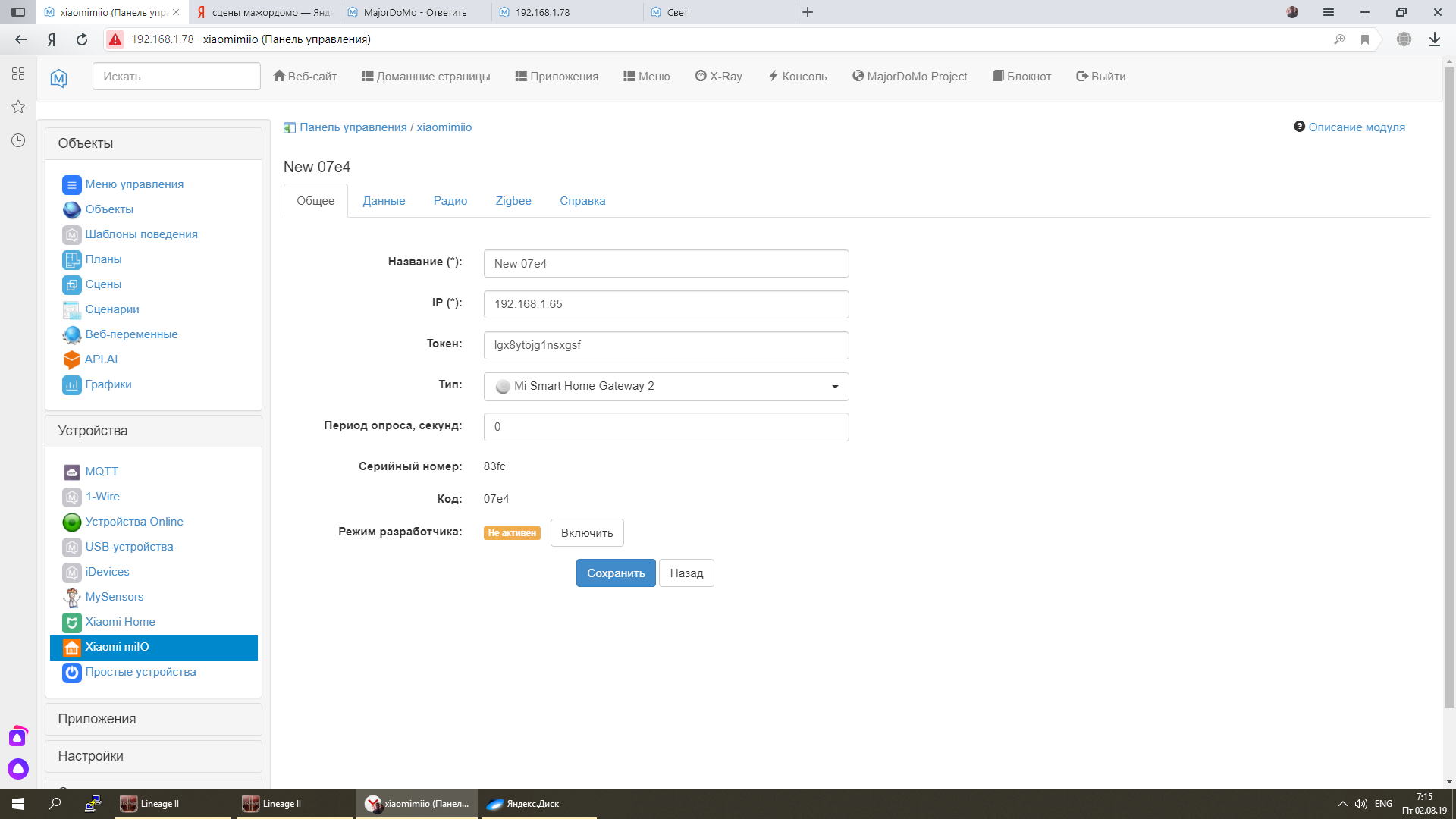

Всем доброго времени суток. Пытаюсь подключить два шлюза Mi Smart Home Gateway 2. Milo их находит оба в статусе онлайн, однако при получении информации пишет Сведения miIO.info не получены. Вероятно, указан неверный токен. Хотя оба токена верные и с Xiaomi Home работают нормально.
Вывод отладки:
miIO Info
Connection to device by IP 192.168.1.65 Debug status [1] Socked created Command to send - {"id":1564668742,"method":"miIO.info","params":[]} Checking device status by 192.168.1.65 Timeout SO_RCVTIMEO successfully set »»> Sending hello-packet to 192.168.1.65 with timeout 2 »»> Sent 32 bytes to socket ««< Reply received from IP 192.168.1.65 , port 54321 32 bytes received magic: 2131 length: 0020 —> 32 bytes unknown1: 00000000 devicetype: 07e4 serial: 83fc ts: 0003dd08 —> 253192 seconds —> 1970-01-04 01:19:52 timediff: -1564415550 checksum: 00000000000000000000000000000000 ts_server: 5d42f346 —> 1564668742 seconds —> 2019-08-01 17:12:22 Device 192.168.1.65 available Timeout SO_RCVTIMEO successfully set Incorrect tokent format! »»> Sending packet to 192.168.1.65 with timeout 2 magic: 2131 length: 0060 —> 96 bytes unknown1: 00000000 devicetype: 07e4 serial: 83fc ts: 0003dd08 —> 253192 seconds —> 1970-01-04 01:19:52 timediff: -1564415550 checksum: d661eab6a5666ee027ab1f8d82ace1a0 ts_server: 5d42f346 —> 1564668742 seconds —> 2019-08-01 17:12:22 data: 29c369e9ba1b8712f5cc4f88b0cc09c1db44d23845f2a4ed138ca7574f5ee553aac789a43b29956134f8045e8ad9cc116745f55bfc6ab3221d51cc680a9326ce »»> Sent 96 bytes to socket ««< Reply from IP 192.168.1.65 , port 54321 Read 32 bytes from socket magic: 2131 length: 0060 —> 96 bytes unknown1: 00000000 devicetype: 07e4 serial: 83fc ts: 0003dd08 —> 253192 seconds —> 1970-01-04 01:19:52 timediff: -1564415550 checksum: ffffffffffffffffffffffffffffffff data: Data decrypted: Invalid JSON data. Error: Syntax error Executing trim() Сведения miIO.info не получены. Вероятно, указан неверный токен.
Вывод лога:
17:13:02 0.34057100 Periodic search for devices in the network is finished
17:13:02 0.33974500 Current count of offline devices 0
17:13:02 0.33411700 Update the ip address and the token for the device 192.168.1.73
17:13:02 0.32670900 Update the ip address and the token for the device 192.168.1.65
17:13:02 0.31890500 Update the ip address and the token for the device 192.168.1.69
17:13:02 0.31615400 Current count of devices 3
17:13:02 0.31378900 Reply = {"devices":["{\"devicetype\":\"0f16\",\"serial\":\"8f56\",\"token\":\"ffffffffffffffffffffffffffffffff\",\"ip\":\"192.168.1.69\"}","{\"devicetype\":\"07e4\",\"serial\":\"83fc\",\"token\":\"00000000000000000000000000000000\",\"ip\":\"192.168.1.65\"}","{\"devicetype\":\"035f\",\"serial\":\"7995\",\"token\":\"00000000000000000000000000000000\",\"ip\":\"192.168.1.73\"}"]}
17:13:02 0.31322100 End miIO-discover command
17:12:52 0.15015900 Run miIO-discover command
Мое железо и ось:
 Orange Pi Plus
Armbian Linux 4.19.59-sunxi
Куда копать не пойму.
Благодарил (а): 400 раз
Поблагодарили: 1754 раза
Сообщение skysilver » Чт авг 01, 2019 7:58 pm
Gastello007 писал(а):
Чт авг 01, 2019 7:50 pm
Скриншоты главной страницы модуля, настроек модуля, вкладок Общее у обоих шлюзов?
Gastello007
Сообщения: 20
Зарегистрирован: Чт авг 01, 2019 5:06 pm
Благодарил (а): 3 раза
Поблагодарили: 8 раз
Сообщение Gastello007 » Пт авг 02, 2019 7:18 am
Сообщение skysilver » Пт авг 02, 2019 9:16 am
Токен у шлюзов неверный. Это ключ режима разработчика, а не токен.
