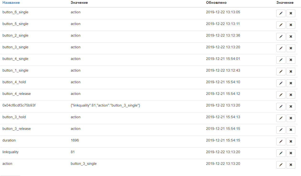

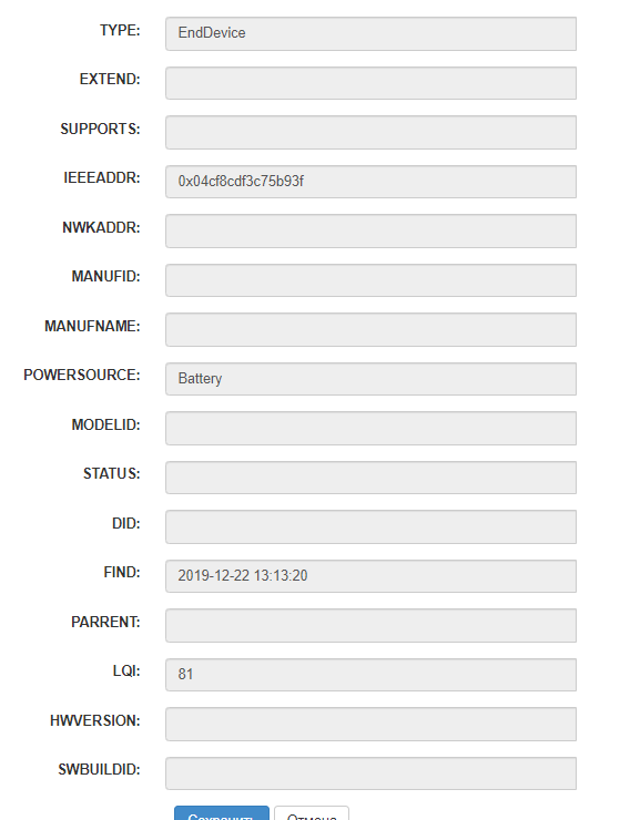

Прошу добавить настенные выключатели (пульты) Aqara x OPPLE Zig Bee 3.0 WXCJKG13LM
button_6_single       action	2019-12-22 13:13:05
button_5_single       action	2019-12-22 13:13:11
button_2_single       action	2019-12-22 13:12:36
button_3_single       action	2019-12-22 13:13:20
button_4_single       action	2019-12-21 15:54:01
button_1_single       action	2019-12-22 13:12:43
button_4_hold         action	2019-12-21 15:54:10
button_4_release     action	2019-12-21 15:54:12
0x04cf8cdf3c75b93f {"linkquality":81,"action":"button_3_single"}	2019-12-22 13:13:20
button_3_hold         action	2019-12-21 15:54:13
button_3_release     action	2019-12-21 15:54:15
duration 1696                   	2019-12-21 15:54:15
linkquality 81                    	2019-12-22 13:13:20
action button_3_single      	2019-12-22 13:13:20
TOPIK	MESSAGE	ADDED
zigbee2mqtt/0x04cf8cdf3c75b93f	{"linkquality":81,"action":"button_3_single"}	2019-12-22 13:13:20
zigbee2mqtt/0x04cf8cdf3c75b93f	{"linkquality":78,"action":"button_3_single"}	2019-12-22 13:13:14
zigbee2mqtt/0x04cf8cdf3c75b93f	{"linkquality":81,"action":"button_5_single"}	2019-12-22 13:13:11
zigbee2mqtt/0x04cf8cdf3c75b93f	{"linkquality":81,"action":"button_5_single"}	2019-12-22 13:13:08
Изображение пульта
