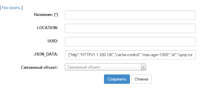

Synology добавил как пустую запись
JSON
{"http":"HTTP\/1.1 200 OK","cache-control":"max-age=1900","st":"upnp:rootdevice","usn":"uuid:73796E6F-6473-6D00-0000-001132097ecf::upnp:rootdevice","ext":"EXT:","server":"Synology\/DSM\/","location":"http:\/\/:5000\/ssdp\/desc-DSM-eth0.xml","description":[false]}
А вот колонки гугл не добавилось.
