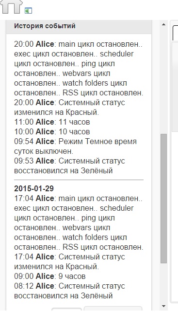

После успешной установки MDM на платформу Pegatron (Nettop) долго не хотел беспокоить своими вопросами, но столкнувшись с чудесами, решил-таки обратиться к специалистам.
Проблема: падают циклы

Один из текущих логов /var/www/debmes/2015-02-02.log
09:53:50 DEBUG [root]: Starting ./scripts/cycle_execs.php ... (at /var/www/lib/general.class.php:417)
09:53:50 DEBUG [root]: Starting ./scripts/cycle_zwave.php ... (at /var/www/lib/general.class.php:417)
09:53:50 DEBUG [root]: Starting ./scripts/cycle_ping.php ... (at /var/www/lib/general.class.php:417)
09:53:50 DEBUG [root]: Starting ./scripts/cycle_main.php ... (at /var/www/lib/general.class.php:417)
09:53:50 DEBUG [root]: Starting ./scripts/cycle_snmp.php ... (at /var/www/lib/general.class.php:417)
09:53:50 DEBUG [root]: Starting ./scripts/cycle_X101_skype.php ... (at /var/www/lib/general.class.php:417)
09:53:50 DEBUG [root]: Starting ./scripts/cycle_modbus.php ... (at /var/www/lib/general.class.php:417)
09:53:50 DEBUG [root]: Starting ./scripts/cycle_bluetooth.php ... (at /var/www/lib/general.class.php:417)
09:53:50 DEBUG [root]: Starting ./scripts/cycle_connect.php ... (at /var/www/lib/general.class.php:417)
09:53:50 DEBUG [root]: Starting ./scripts/cycle_onewire_starred.php ... (at /var/www/lib/general.class.php:417)
09:53:50 DEBUG [root]: Starting ./scripts/cycle_rss.php ... (at /var/www/lib/general.class.php:417)
09:53:50 DEBUG [root]: Starting ./scripts/cycle_webvars.php ... (at /var/www/lib/general.class.php:417)
09:53:50 DEBUG [root]: Starting ./scripts/cycle_onewire.php ... (at /var/www/lib/general.class.php:417)
09:53:50 DEBUG [root]: Starting ./scripts/cycle_scheduler.php ... (at /var/www/lib/general.class.php:417)
09:53:50 DEBUG [root]: Starting ./scripts/cycle_states.php ... (at /var/www/lib/general.class.php:417)
09:53:50 DEBUG [root]: Starting ./scripts/cycle_skype.php ... (at /var/www/lib/general.class.php:417)
09:53:50 DEBUG [root]: Starting ./scripts/cycle_watchfolders.php ... (at /var/www/lib/general.class.php:417)
09:53:51 DEBUG [root]: Closing thread: /usr/bin/php -q ./scripts/cycle_zwave.php --params "a:0:{}" (at /var/www/lib/general.class.php:417)
09:53:51 DEBUG [root]: Closing thread: DISPLAY=:101 /usr/bin/php ./scripts/cycle_X101_skype.php --params "a:0:{}" (at /var/www/lib/general.class.php:417)
09:53:51 DEBUG [root]: Closing thread: /usr/bin/php -q ./scripts/cycle_onewire_starred.php --params "a:0:{}" (at /var/www/lib/general.class.php:417)
09:53:51 DEBUG [root]: Closing thread: /usr/bin/php -q ./scripts/cycle_snmp.php --params "a:0:{}" (at /var/www/lib/general.class.php:417)
09:53:51 DEBUG [root]: Closing thread: /usr/bin/php -q ./scripts/cycle_bluetooth.php --params "a:0:{}" (at /var/www/lib/general.class.php:417)
09:53:51 DEBUG [root]: Closing thread: /usr/bin/php -q ./scripts/cycle_connect.php --params "a:0:{}" (at /var/www/lib/general.class.php:417)
09:53:51 DEBUG [root]: Closing thread: /usr/bin/php -q ./scripts/cycle_skype.php --params "a:0:{}" (at /var/www/lib/general.class.php:417)
09:53:51 DEBUG [root]: Closing thread: /usr/bin/php -q ./scripts/cycle_onewire.php --params "a:0:{}" (at /var/www/lib/general.class.php:417)
09:53:51 DEBUG [root]: Closing thread: /usr/bin/php -q ./scripts/cycle_modbus.php --params "a:0:{}" (at /var/www/lib/general.class.php:417)
10:00:00 DEBUG [root]: Executing (exclusive): mplayer /var/www/sounds/dingdong.mp3 (at /var/www/lib/general.class.php:417)
10:00:03 DEBUG [root]: Executing (exclusive): cscript /var/www/rc/sapi.js 10 часов (at /var/www/lib/general.class.php:417)
11:00:00 DEBUG [root]: Executing (exclusive): mplayer /var/www/sounds/dingdong.mp3 (at /var/www/lib/general.class.php:417)
11:00:03 DEBUG [root]: Executing (exclusive): cscript /var/www/rc/sapi.js 11 часов (at /var/www/lib/general.class.php:417)

Падение происходит странным образом, запускаю из консоли или через вэб, запускаются циклы и все ок, закрываю сессию, из которой запускал, циклы падают, когда захожу на вэб-интерфейс. На экране вижу информацию, что пару часов система работала, отмечая смену часа, потом тишина.
Еще странно, что система постоянно показывает, что нет Интернета, хотя он есть.

Где посмотреть этот лог в виде файла, если запускаешь не из консоли или без указания в консоли записи в лог?
Здесь видно, что запускал в 9:53, затем пару часов явно система регистрировала смену часа, значит циклы работали, потом тишина. Зашел на вэб-интерфейс в 20:00 и здесь увидел, что система упала, но почему об этом не было информации до того?

Config.php. Честно говоря, меня немного смутил этот config.php, так как когда я его делал из файла config.php.sample, то там этот кусок кода был.
p.s. MDM я развернул на Debian Gnu/Linux. Исходники брал с гитхаба. В качестве железа? на котором все крутится, выступает HP Microserver Gen8. Так вот... пока я не заставил замолчать алису, у меня mdm падал из-за того что на данном серваке нет звуковухи.
