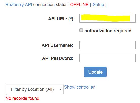

Re: MajorDoMo with Z-Wave
Does anybody know what API URL is expected for Razberry setup, see picture?
- Razberry URL.JPG (29.41 КБ) 18266 просмотров
It's HTTP API url. Please try to set http://localhost:8083/ap2017 писал(а):Does anybody know what API URL is expected for Razberry setup, see picture?
Also I suppose username/password should be set as well.
And one more thing, please check your Z-Wave API access settings in Z-Wave panel: Apps=>Z-Wave Network Access uses app Z-Wave Network Access=>Allow public access to Z-Wave API (make sure it is turned on).

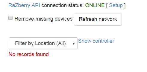

Thank you. The API status became ONLINE when I use API HTTP url http://localhost:8083/smarthome/#/dashboard and after I made access changes as you suggestedsergejey писал(а):It's HTTP API url. Please try to set http://localhost:8083/ap2017 писал(а):Does anybody know what API URL is expected for Razberry setup, see picture?
Next step. I configured Z-Wave API to see my thermostat, see screen capture, but not sure how this is suppose to link with MajorDoMo? What supposed to happen when I click on Show Controller? I would expect that next step would be associating objects with available z-wave devices, but not sure how it works. Sorry for taking so much of your time.
- Devices.JPG (21.63 КБ) 18227 просмотров
- ZWave.JPG (33.99 КБ) 18227 просмотров
Could you try to click on "Refresh network" button in MajorDoMo? You should get devices added to MajorDoMo after that. Let me know how it goes.ap2017 писал(а):Next step. I configured Z-Wave API to see my thermostat, see screen capture, but not sure how this is suppose to link with MajorDoMo? What supposed to happen when I click on Show Controller? I would expect that next step would be associating objects with available z-wave devices, but not sure how it works. Sorry for taking so much of your time.
