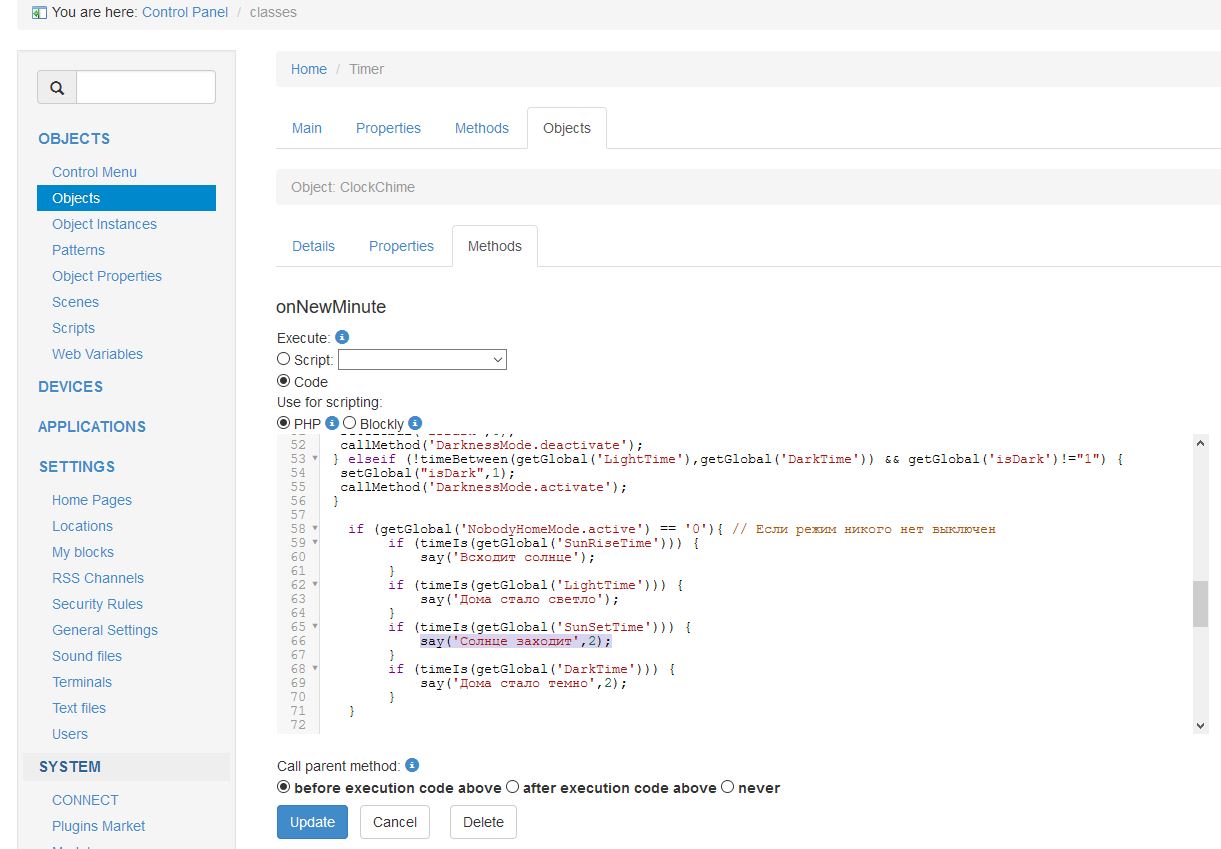

However, searching the forum is a bit more challenging and I cannot find a way to turn off Alice announcing time every hour "17 часов", "18 часов" ...
I searched in database, found already said messages in the logs, I searched in code, control panel but I had no luck finding the term and how to turn it off.
I found something in table Methods that mentions "onNewMinute', where it says "Солнце заходит" (which is something I would also like to disable, or at least translate to english so that Alice can pronounce it properly).
Where can I find these scripts, how are they run (by which module/script)?

I managed to trace the clockChimeEnabled as property of ThisComputer and set it to 0, which turned off the pronouncing of the time (as it was in the IF)
